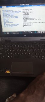

Unlock Bios Password Lenovo yoga password
Micro-computers
Mekvit

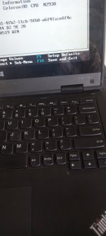

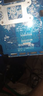

turn on the laptop. when display came immediately short 200&202 pin of ram .laptop run into setup directly or pressing f1. when setup open then release pins.go to security press anter 3time in administrator password. save and exit your password is broken.;)
Does programming bios remove password
sultan321
allhamdulillah we break around 1000 pieces password with this mathod
